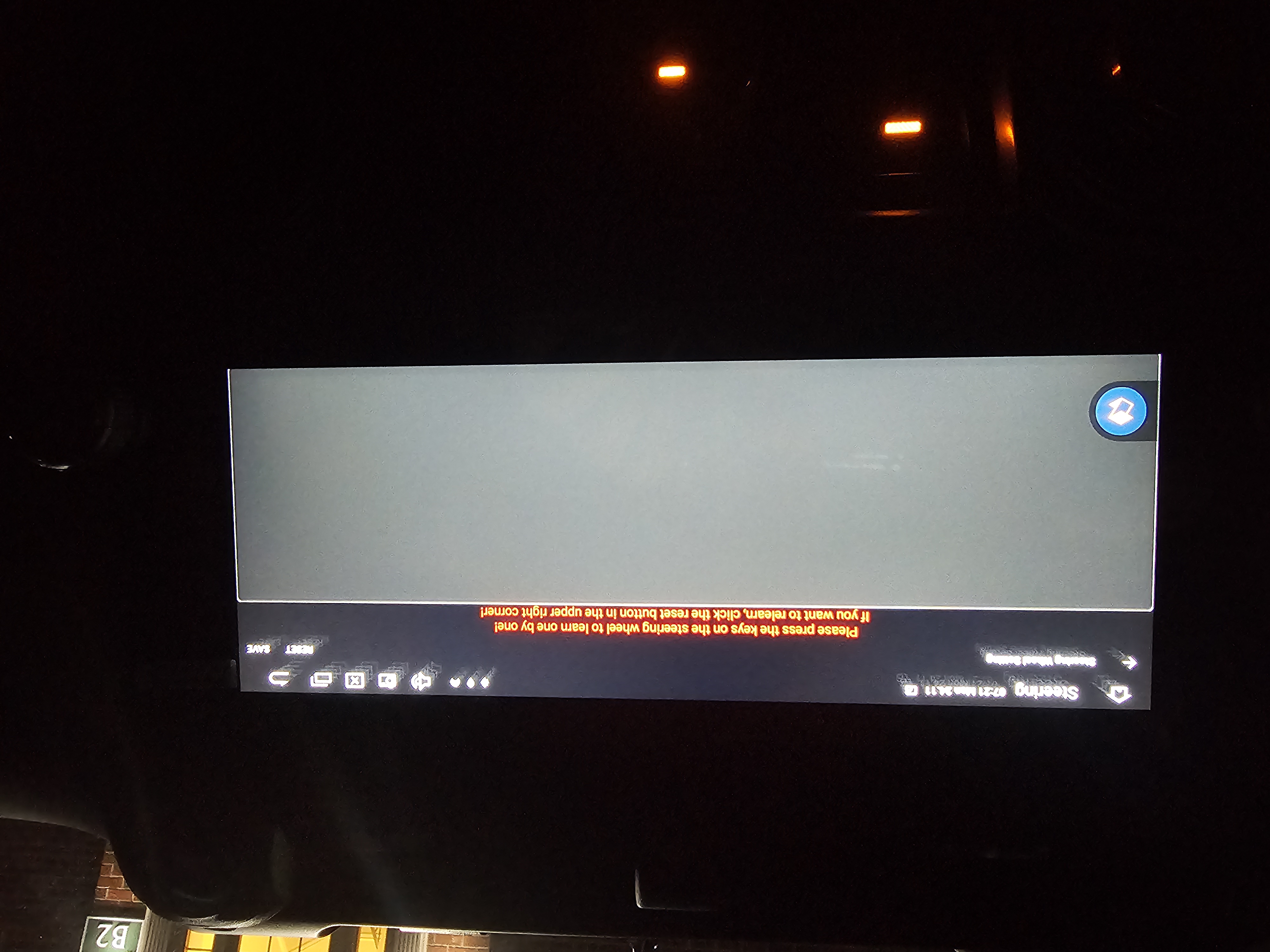

    For head units without a Canbus box. You'll need to set the steering wheel keys manually.
    1.Go to the Car Setting > Steering Wheel Setting.
    2.Click on the function on the stereo and then press the corresponding button on the steering wheel to learn.
    3.Click the RESET button to re-learn.
