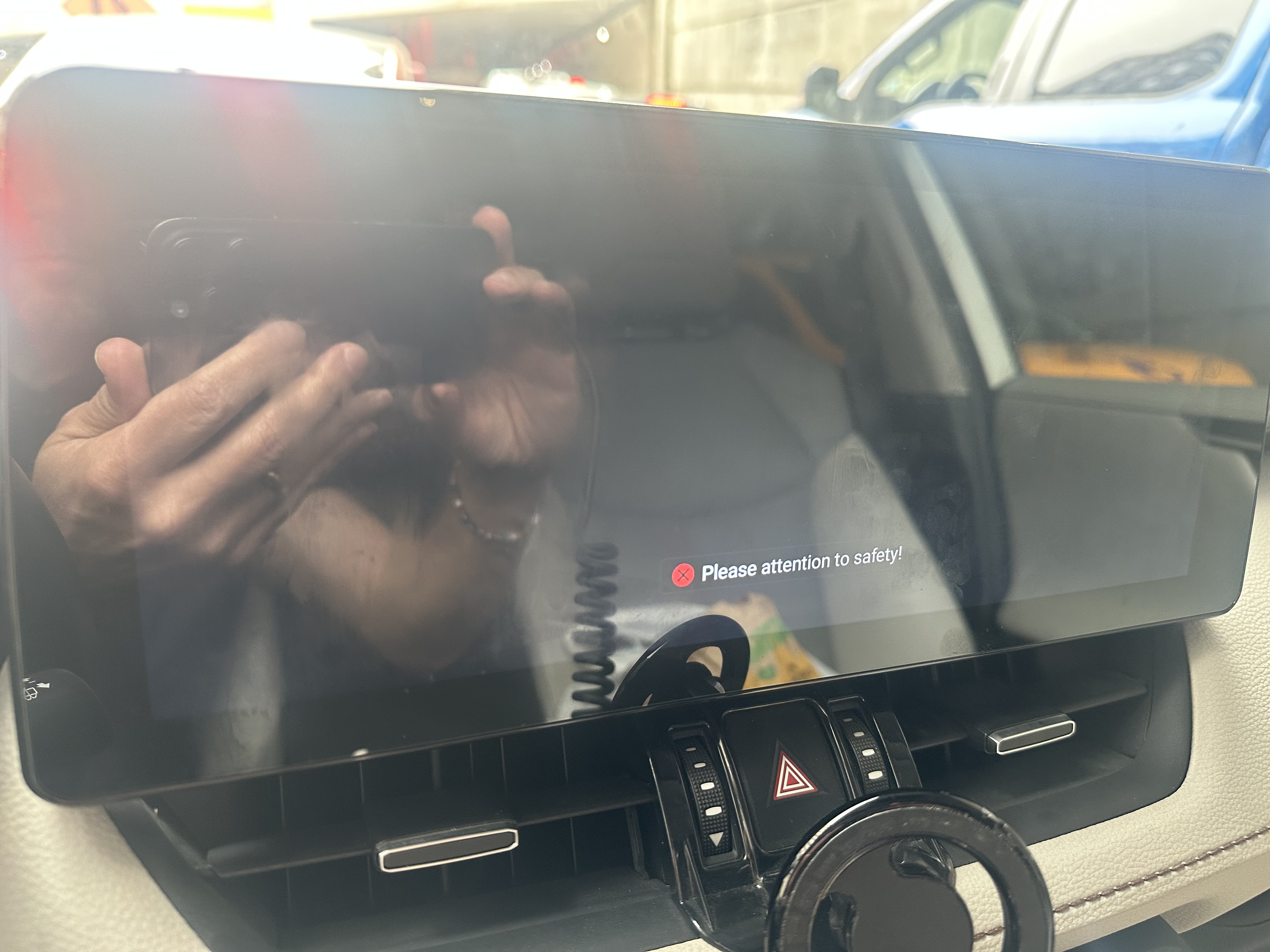

Hello, I lost my front camera after encountering some issues and I thought updating to the latest software might help. The issue is fixed but now my front camera won't show up.

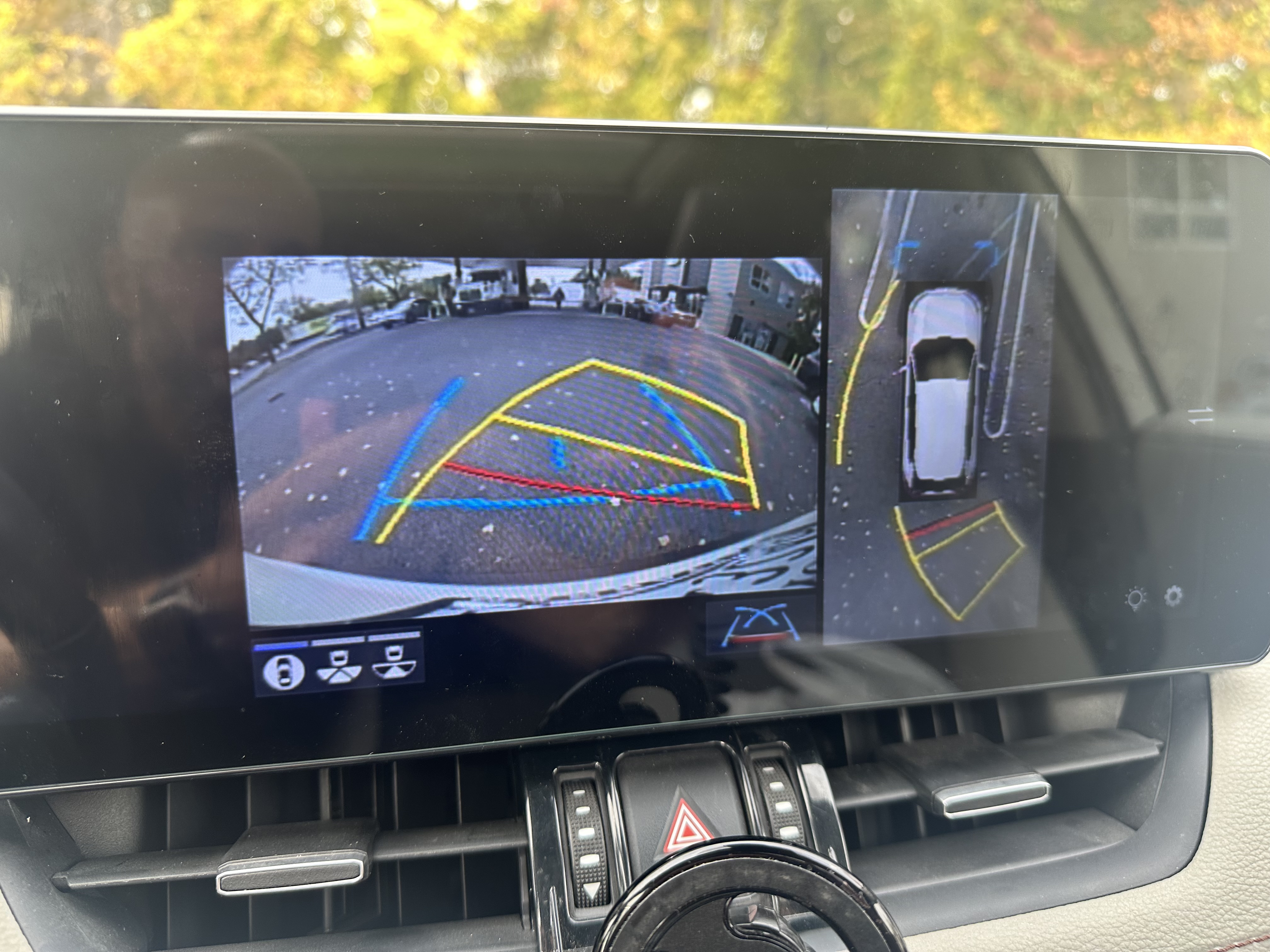

yes the front camera is part of the 360 camera, the backup camera is working without issue and when in PARK and turn on the 360 camera the front camera works as I can see the front of the vehicle in the 360 view. But when the car is in DRIVE and I drive up to a object/building and trigger the front collision sensor normally the front camera will turn on, but now I'm getting a black screen like the first image in the post above. I believe it's the Canbus setting is the issue but I can't figure out what is wrong.
